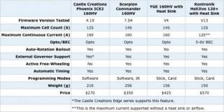

Alright, let’s look at what ESC’s I’ll be reviewing and check out what categories I’ll be considering…
As far as categories go, I tried to choose a balanced set to consider, but obviously I’m going to be spending a good portion of my time talking about the governors. I’ll be scoring them numerical from one (best) to four (worst), such that the winner will have the lowest overall score. Here they are:
1. Ease of Setup – From the time you pull it out of the box until the first flight, how easy is it to go through the setup process?
2. Ease of Tuning – Once you’re in the air, how easy is it to tune the governor to that feel you’re looking for?
3. Governor Performance – Now that you’ve got it tuned, how does the governor perform under a variety of different flight and loading conditions?
4. Auto-Rotation Bailout – Ok, you’re done with your flight now, so let’s see how we do bailing out of a crazy aerobatic auto!
5. Overall – And the verdict is…?

5. Overall
Ok, so that’s it. What does it all mean? Well, before I unveil the final scores, I want to remind everyone that these are all my opinions and I’m quite certain that they’re not shared by everyone who’s flown these ESC’s, but that’s what’s nice about this kind of review, right? Again, to get my final scores, I took the score for each ESC in each category and added them up. Lowest score wins…
I guess it’s not surprising that the Kontronik won, but I was surprised to see that the YGE came in tied for last with the Castle. In fairness to the YGE though, the lack of bailout isn’t the same “bad” score as last place for governor performance. If you got rid of the bailout as a factor in your decision-making process though, you’d get the YGE tied with the Scorpion and just behind the Kontronik with the Castle bringing up the rear.
Now, what if we consider that these would be used for external governing? How does that affect the score? Well, that’s when it becomes a lot more personal of a choice. If you eliminate the internal governor, then you eliminate the ease of tuning and governor performance categories. All of a sudden, everyone is tied…well, except for the poor YGE because of it’s lack of bailout. Nevertheless, you now have to start considering other stuff like weight, price, and reliability (whether perceived or real). For weight, the Kontronik can’t be beat at only 150 grams with a heat sink, but damn that price tag stings! On the other hand, the Castle is the king of the affordability category at a mere $275, but tops the scales at 210 grams! Is a BEC an important feature to you? Well, then you’re stuck with the Kontronik, so get out that credit card and let’s hope your wife doesn’t see next month’s statement!
So, what’s most important to you? How would you rate these ESC’s based on your personal experience? Maybe the internal governor argument is a relatively easy one to make, but the external governor clouds things, doesn’t it?
Thank you for being so patient with me on this review and I hope that it provides you with some food for thought whether you agree with my conclusions or not. I’m always interested in hearing from others regarding their thoughts on debates such as these, so feel free to leave a comment, hop on our forums, or toss me an email at justin@rchelination.com.
